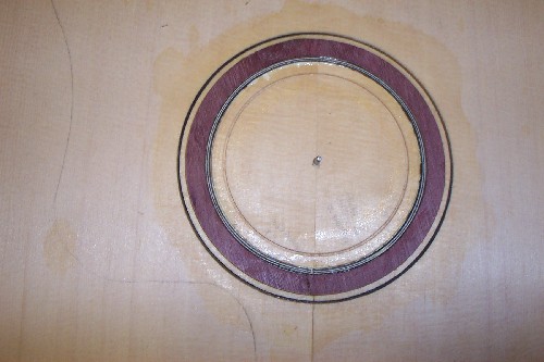

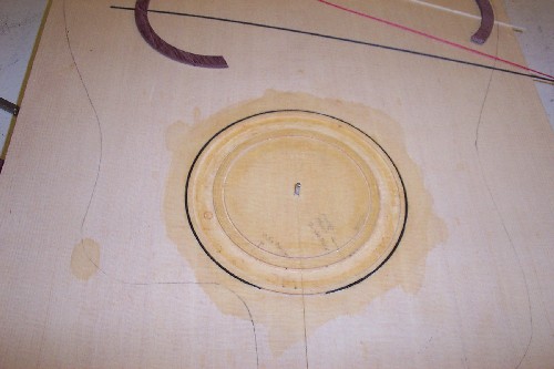

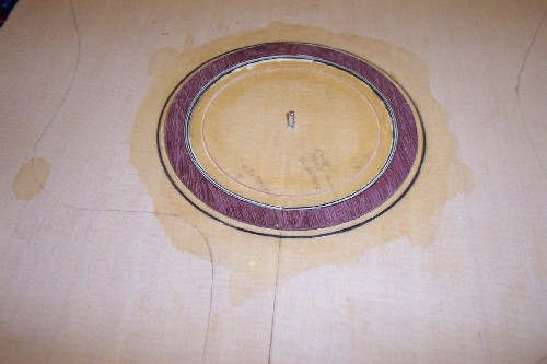

Thanks for all the info guys, i have my rosette glued in, went well except from the swelling that Brock mentionned. I had to put some weight over it to keep it from getting out of there but it seems to be all right, i'll be checking it out tomorrow morning if it swelled too much.
Her are a couple of pics, let me know what you think please, if i should take it out or not.
The purple heart is hard to cut and easy to break, i had the piece crack on me twice an got a rosette in 2 pieces
Serge Poirier38803.0014351852
PostPosted: Sun Mar 26, 2006 3:11 pm
Looks great there Serge. Well done.
On thing you might want to be carful of if this is your layout is that the cut away is very low, so you may some problems with your top purfling (if you are putting top purfling on). It will get close to your rosette.
Otherwise looks like your well on your way there bud.

PostPosted: Sun Mar 26, 2006 4:05 pm
Serge, your rosette is looking good! Looks gap-free, so as long as it's securely glued you should be O.K.
I think Rod is right about your cutaway. You could retain the shape as it is, and just move the whole thing up a bit to give more space between the edge and rosette. I might also mention, though, that anywhere the side contour straightens, you have a weak spot. As we know, an arch makes a wood plate stronger! You could leave the cutaway where it is, and make your curve into the neck block in a larger radius (that is, start the bend sooner and end it later). That'll also give you more space between the edge and the rosette. Or, you could just do it the way you want, and you'll probable still end up with a good guitar!
PostPosted: Sun Mar 26, 2006 4:23 pm
You will end up with a good guitar as Carlton said if you do it your way Serge, but you realy don't need that much access to the upper frets. I would pull the entire cut away up about 1" than you wouldn't have to worry bout the purfling scheme you choose.
Have you made the inside mold for bending yet? That my be your deciding factor.

PostPosted: Sun Mar 26, 2006 10:02 pm
Serge, the rosette looks great. Did you already flood it with CA? It appears that way but it might just be the sealer on the top.
I know it's after the fact but I'll throw my $.02 in for next time. If you are dealing with mulitple lines like purfling lines on the inside and outside, it's much easier to get the whole mess in the slot then when you are happy with it, hit it with CA. To me, there's nothing more frustrating than trying to get a part put in place when you have wet glue hindering your progress. I've had my doubts about the structural aspects of CA but this area isn't receiving much stress so I'm confident it will last a lifetime with CA.
In regards to your cutaway:both Rod and Carlton have great points. If it were me, I'd be concerned about the proximity to the rosette as well as the flat of the cutaway. You could easily fix both of these problems by increasing the radius of the inside curve. Not to mention that you'll be increasing your chances of a successful bend!
